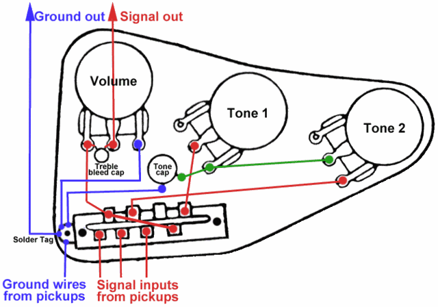

    « Reply #10 on: September 17, 2010, 09:13:06 AM »
  • Stratocaster wiring, with trebble bleed, star grounding and bridge PU to tone pot.
    While the Trebble bleed and tone pot wiring are to taste - I strongly recommend the Star grounding.  Its made my strat almost hum free, in a small room with a PC and two monitors, an amp and flourescent lights !!.  The round bit the ground wires are attached to is a solder tag mounted between the scrath plate and the PU selector using the selector screw.

    Re: Schematics
    « Reply #11 on: September 17, 2010, 05:05:48 PM »
  • I also use a thin peice of metal to connect all pot casings together, not sure if that is left off pic for reason?
    Offline paulmapp8306
    • Posts: 503
    • Karma: +13/-0
    Re: Schematics
    « Reply #12 on: September 17, 2010, 08:03:42 PM »
  • I left all the pot casings unconnected.  you dont need to earth the pot casings, if fact doing so adds to hum - you dont want them in the earth circuit.

    Re: Schematics
    « Reply #13 on: September 18, 2010, 01:14:31 AM »
  • I love this circuit but it's causing me a bit of grief with grounding problems at the minute... >:(

    Re: Schematics
    « Reply #14 on: July 04, 2013, 12:17:22 PM »
  • I'm attempting to follow this diagram during an overhaul of my Yamaha bass.
