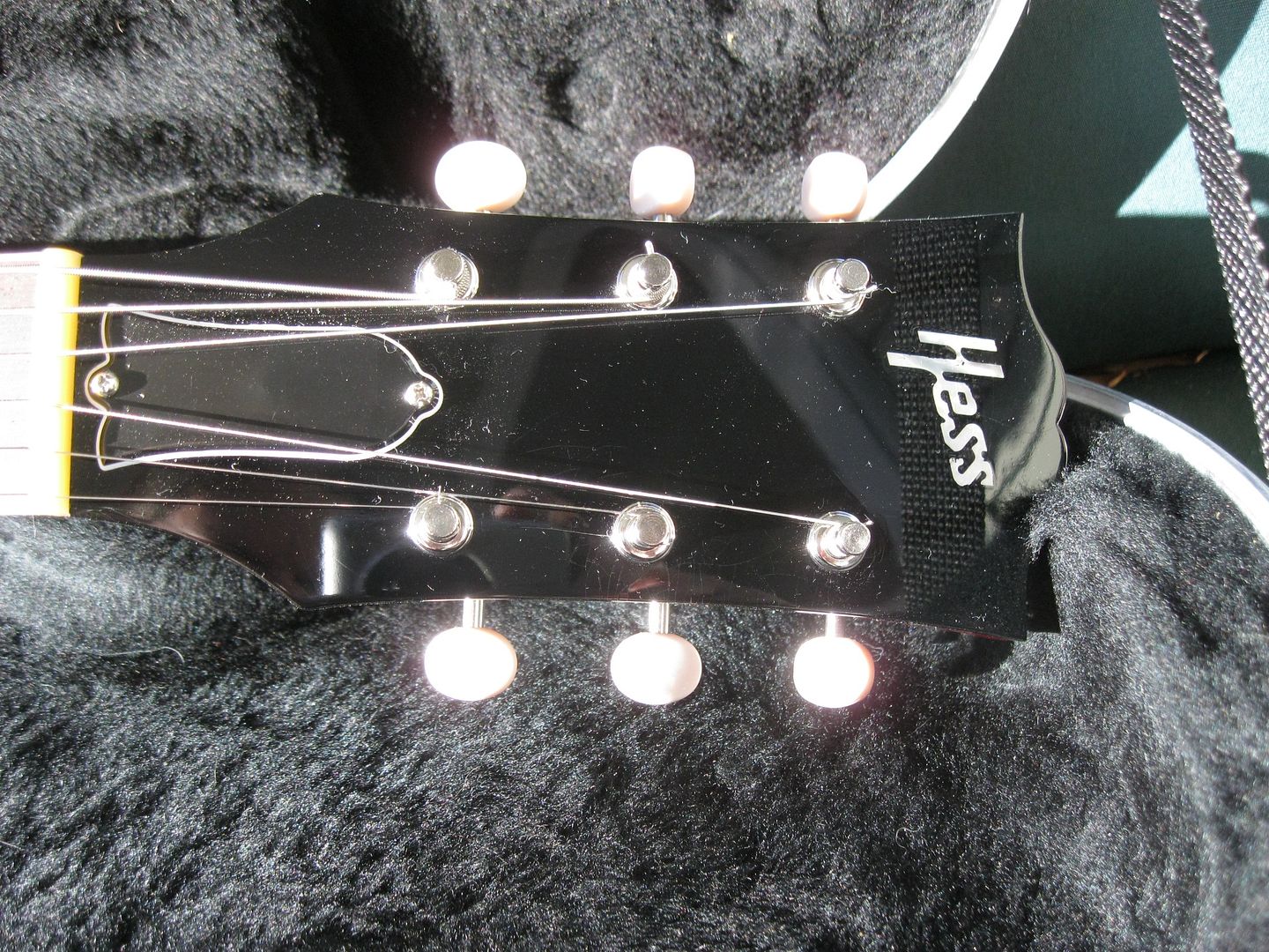

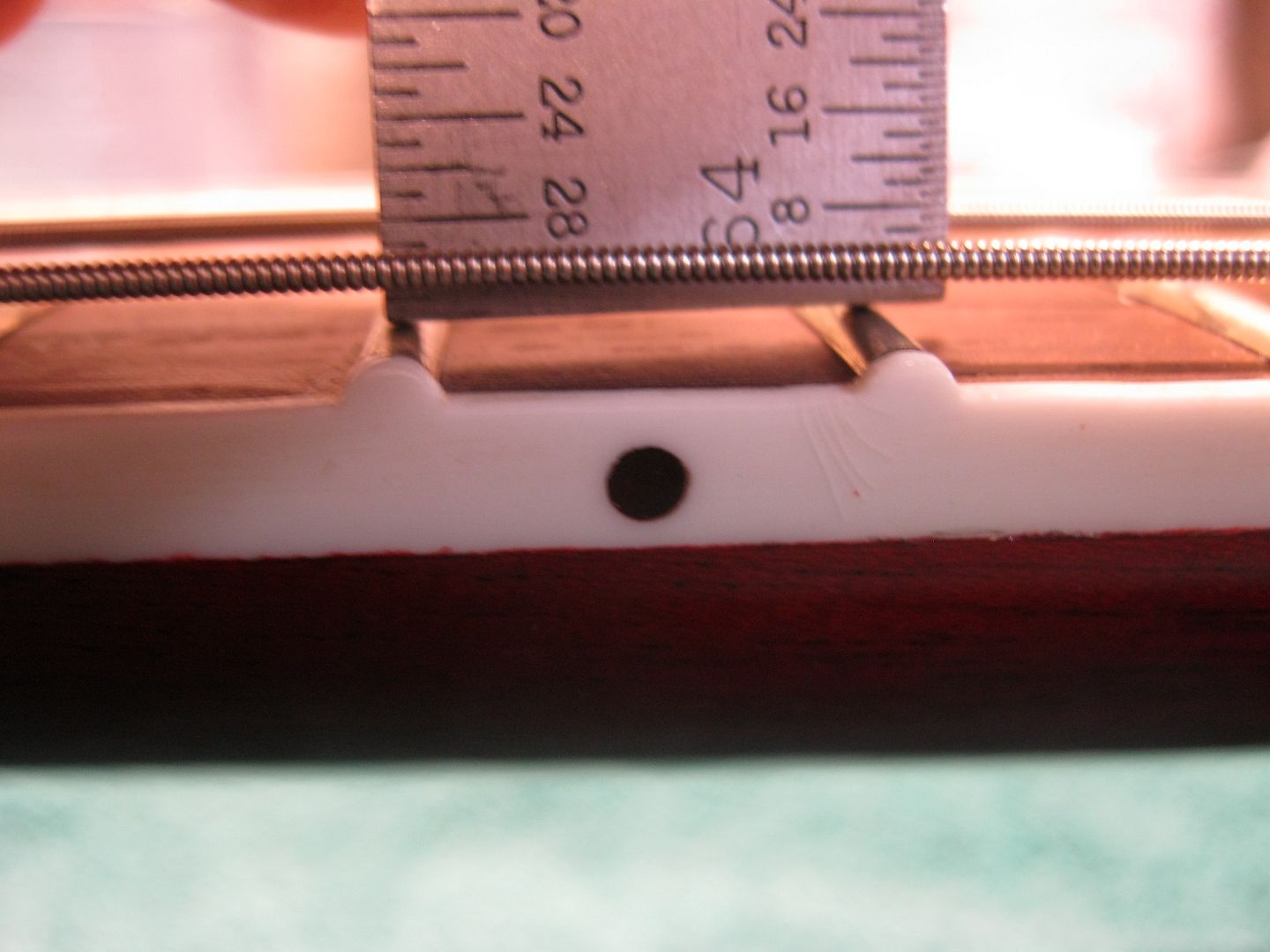

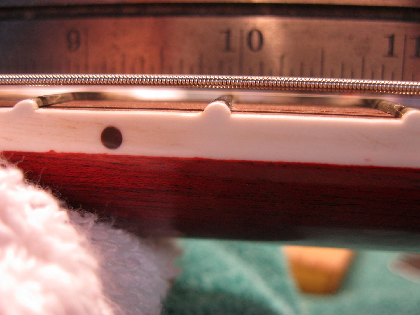

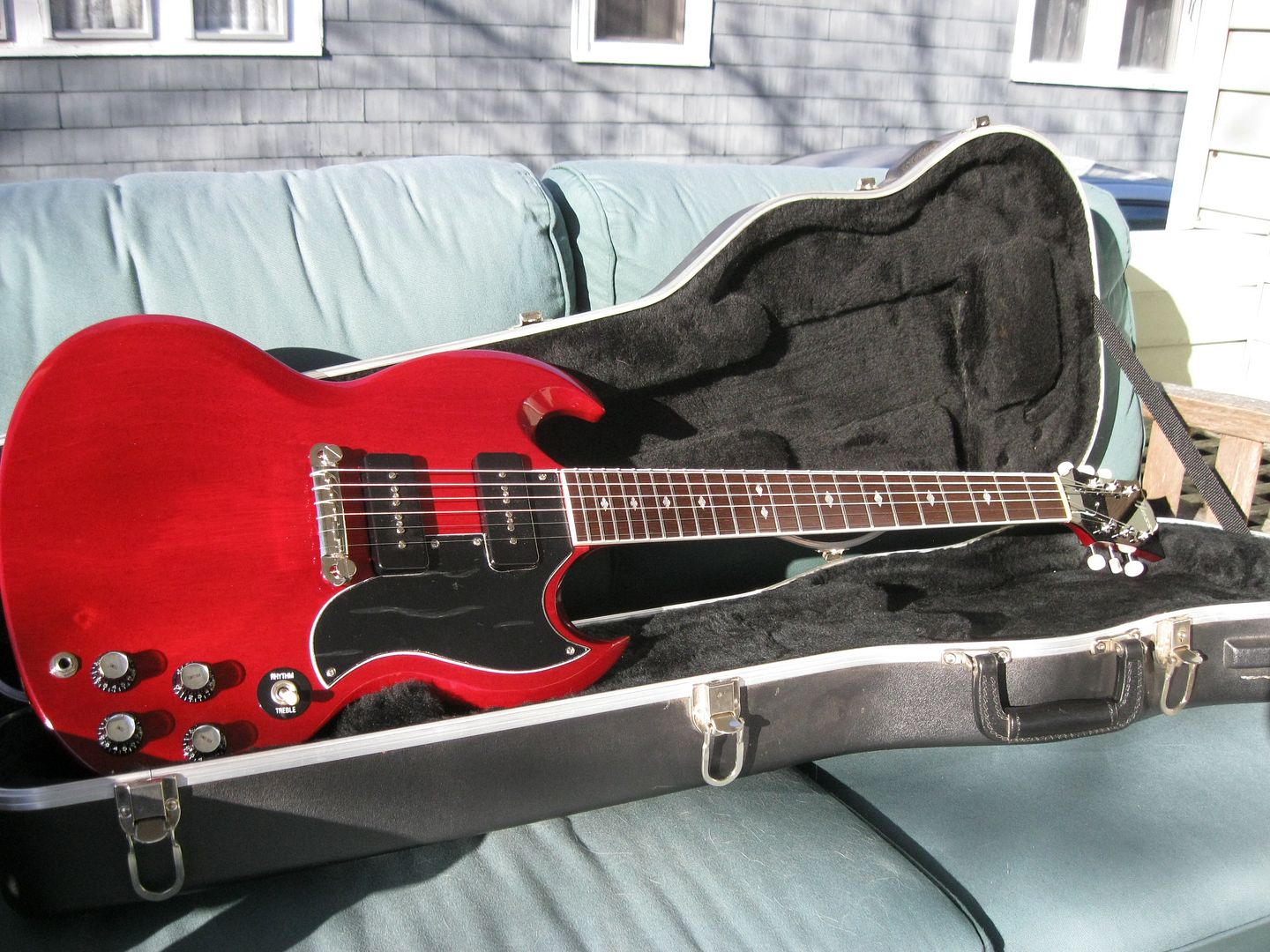

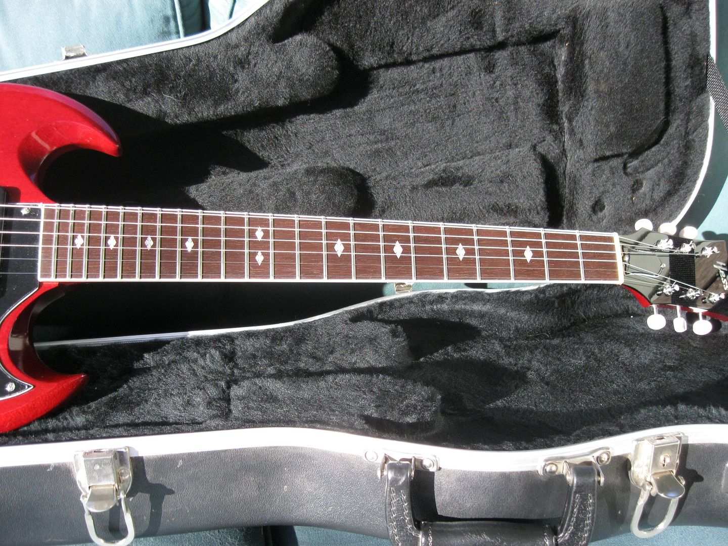

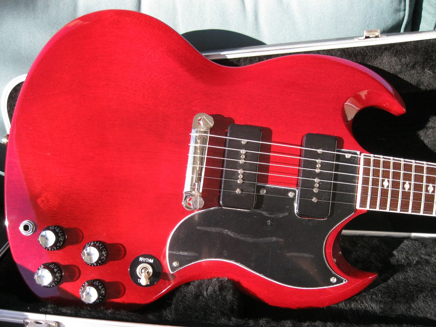

  • Sorry for the lack of updates. The Special is all done, and on it's way to England. BQ was here Sunday, and spent two hours playing it before he would put it down.
    Here's some finished shots out in the sun.
    The action is real low, even with a wound "G" string. The total neck bow is less than .007". The fret height is about .038", or just under 1 mm.
    And, the string height is about .047" (3/64").
    Now to finish up the Junior. I promised to try to deliver it the first weekend in February.

  • Oooooohhh good grief , absolutely stunning John . I should say the guy will be keeping that one for life .
    You really are a craftsman of the highest order John . It's been wonderful seeing the progress of your work to the end result .... Brilliant

  • Great pics of the finished beast John! Did I ask you this before?  What kind of wraparound is that?
    Re: Building a couple of SGs
    « Reply #113 on: January 03, 2016, 04:09:59 PM »
  • Thanks guys.  ;D
    Dave, it is just the cheapo Allparts wrap around. Brendan plays with a wound G, and they are the only source that still offers that option.
