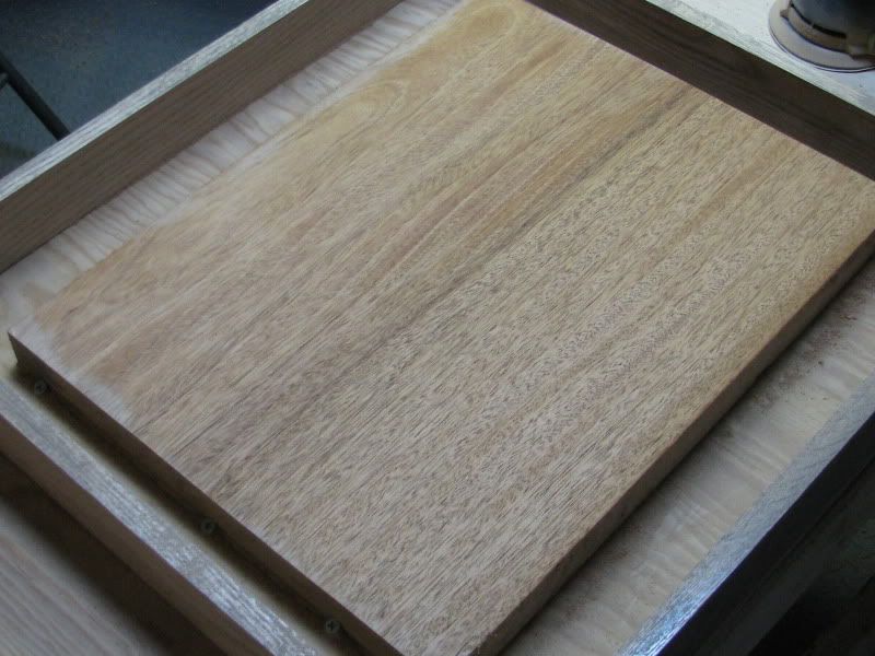

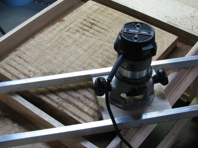

    This is what I have so far. I used my ghetto mill jig to take down the thickness. I used some Khaya (African Mahogany) for the body. It is one of three body blanks I bought at the same time as the two I got for the SGs that I'm building.

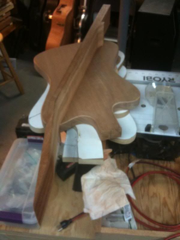

    After the body was milled, the shape was cut out.
    Once that was done, I started working on the neck. It is made from two pieces of Honduran Mahogany. The original necks were one piece, but I had found this really nice two piece blank, and thought it would be more durable.

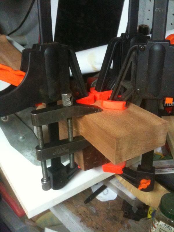

    Unfortunately, when cutting out the headstock, the band saw blade jumped from it's guides. I had to create a scarf joint. this took a lot of work to complete. It is now repaired, and waiting for me to move on to the next step.

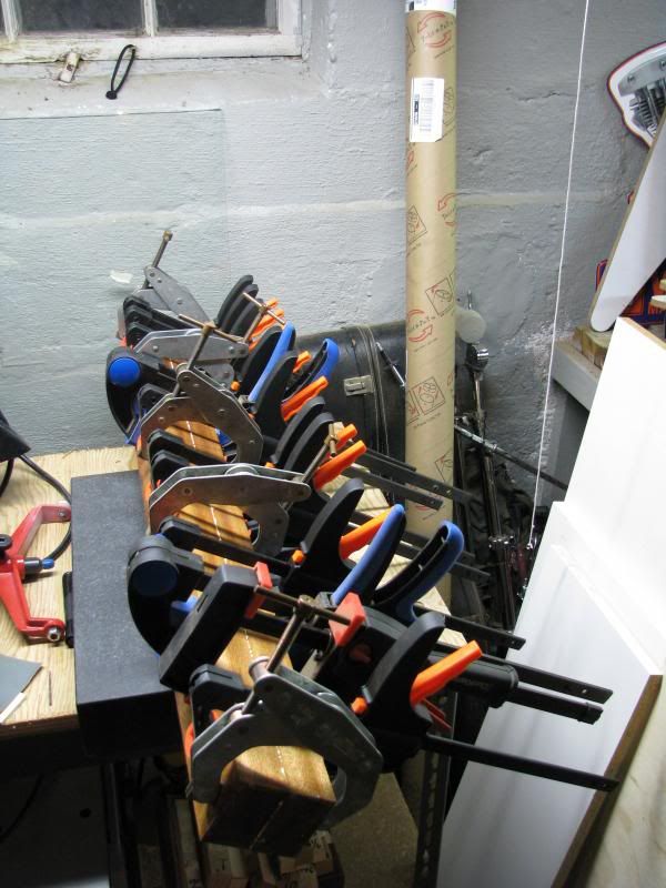

  • Underneath all the aluminum vise jaws and Kant-Twist clamps, is a holly veneer glued to the headstock. Hope to make a bit more progress during the week, then this may sit for a while again.
