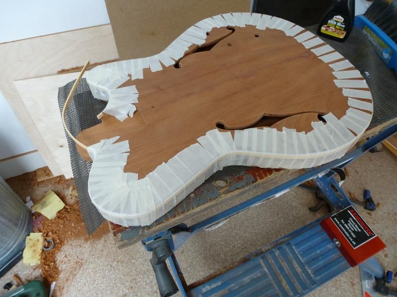

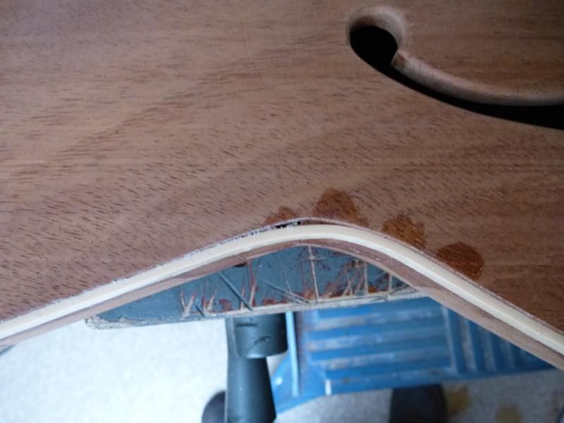

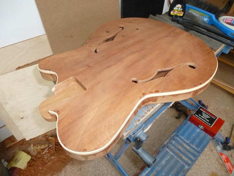

And again I've let it slide a bit with the updates, but not to worry it's slowly but surely progressing towards what will hopefully be a very nice guitar  ;)
Where it's at now: the neck is cut and shaped, not fretted yet. Neck pocket cut. Routed the binding channel around the top and glued the binding in.
And the binding glued up, no process pics as I had to work fairly quickly.
Looking half decent already.
A few small gaps managed to worm their way in there (that's first time binding for ya), so those will be filled with binding sludge, hopefully those will disappear  ;)

Next up on the agenda is lots and lots of scraping to remove all the glue squeeze out and get the binding nice and flush. And when I have access to a column drill I'll drill the mounting holes for the bridge, tailpiece, neck screws (with ferules) and tuners.

Looks like it's coming along nicely, Maurits. Working with binding is a challenge, eh?
 One way to fill those caps is to cut some binding remnants into very small pieces, then add a little bit of acetone to it. The acetone will melt that plastic, and it will become a liquid. It takes a little while for this to happen, and you will need to adjust volumes as you go along. Once you have a nice little paste made up, you can use it to fill the gaps. Once the acetone evaporates, it will turn back to plastic, and adhere nicely to the binding and wood.
Can't wait to see more.
 ;D
It's a bit of a challenge but I'm definitely going to be doing more of it. As a hobbyist guitar maker I've already got the next build planned out in my head (12 string electric), and I wouldn't be surprised if that one will have binding too  ;D
Got some acetone this afternoon and have some pieces of binding dissolving as we speak, tomorrow I'll fill those gaps.

Filling the gaps went quite well, hopefully they will completely disappear after some sanding.
Binding bits and pieces
Dissolving
And applied to the gaps
